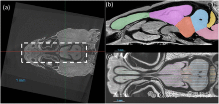

  • 图像对齐与裁剪: 由于样本放置方向不一致,作者使用Dragonfly软件对图像进行对齐和裁剪,确保脑部区域一致,方便后续分析和深度学习训练。
  • 手动分割训练集: 作者在Dragonfly中手动分割了约20-30个切片,作为深度学习模型的训练集。
  • 3D模型重建与可视化: 作者使用Dragonfly将microCT图像重建为3D模型,并对分割后的脑区进行可视化展示。
(a) The images are aligned and cropped to keep the brain for fast segmentation. (b,c) Demonstration of manual segmentation.

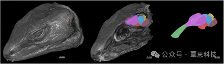

3D rendering of the X-ray microCT images showing the external and internal of the head, and the main parts of the brain. The brain regions are: the olfactory bulb (green), telencephalon (purple), diencephalon (red), midbrain (blue), cerebellum (yellow) and brainstem (pink).
