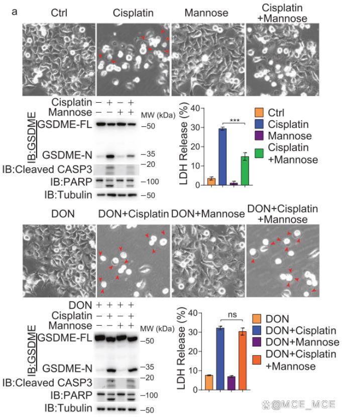

Top, FHs 74 cells were pretreated with mannose and then cisplatin. Bottom, cells were pretreated with mannose and DON (40 μM) and then cisplatin.
